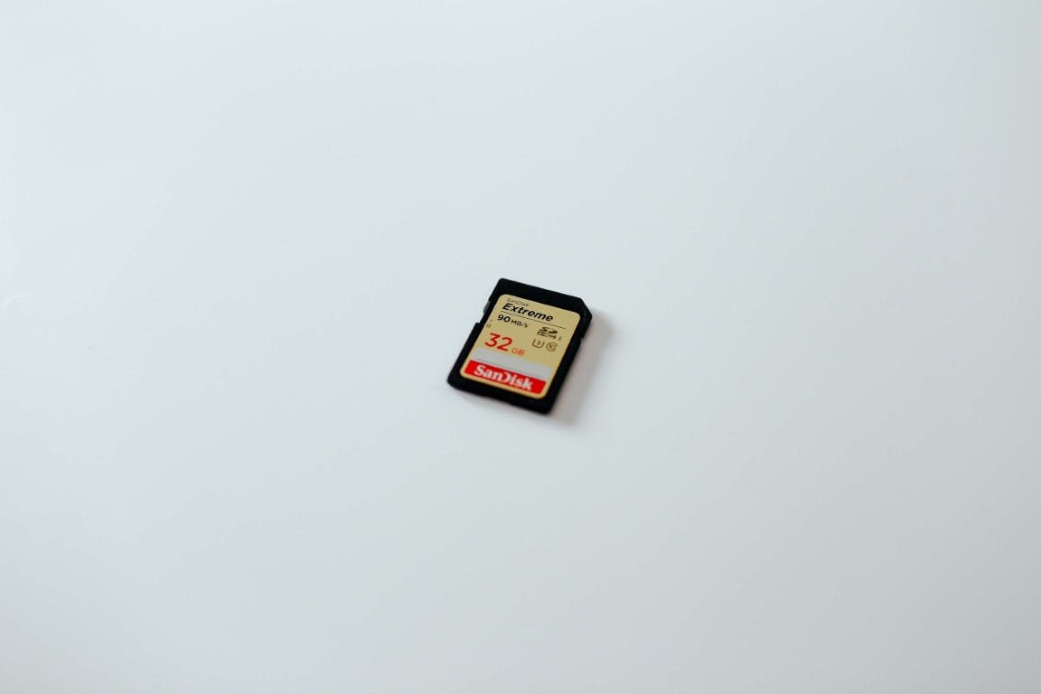

SD Card
The Raspberry Pi doesn’t come with any internal storage of its own. It instead relies on interchangeable SD cards. While it’s possible to store files on a separate computer in your home and access them via Wi-Fi, your Raspberry Pi will need to boot to an operating system that’s stored on an SD card.
The easiest way to do this is through a piece of software called, appropriately enough, NOOBS. A zip file containing the program is available via the Raspberry Pi website. After extracting the zip file, you can simply drag its contents onto the SD card from your File Explorer in Windows or Mac OS.
Raspberry pi sdcard
You can then insert the SD card into your Raspberry Pi and plug it in. You’ll be prompted with a list of operating systems to install. Simply select Raspbian and the rest of the process will be taken care of. After the installation is complete, you’ll be asked to reboot. Once you’ve gotten acquainted with Raspbian, your needs might lead you to install a different operating system. If you’re using the Pi as a media center, for example, then specialized software like OSMC might make life easier.

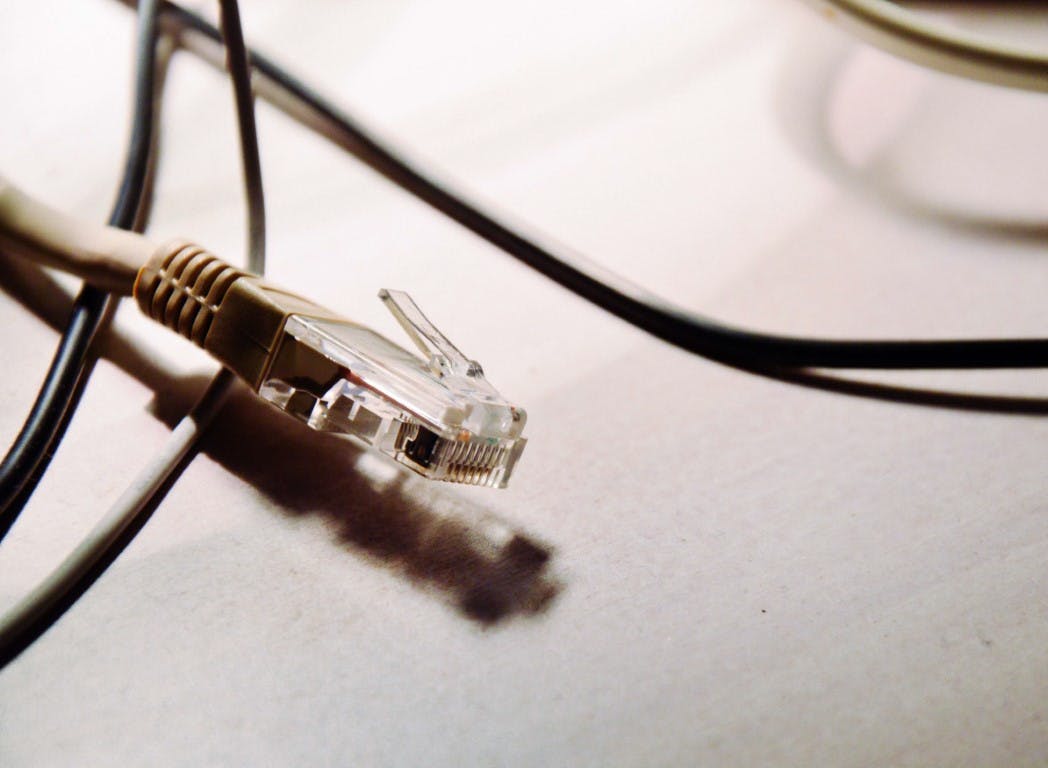

Ethernet
If you’d prefer to do things the old-fashioned way, then you can just as easily plug a standard RJ45 cable into the rear of your Pi. Remember that if you’re connecting your Pi directly into your computer in this way, you’ll need a special ‘crossover’ ethernet cable.

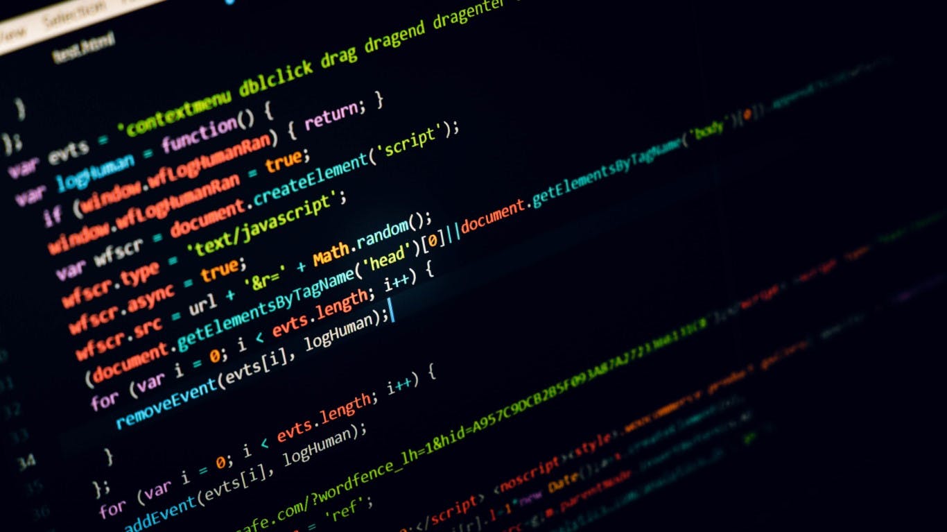

Programming Language
Once you’ve gotten your Raspberry Pi wired up and booted, and you’ve run a few basic programs, you might want to get your hands dirty by creating some programs of your own. Raspberry Pi offers support for a range of languages, but among these, two stand out as noteworthy: Python and C++.
Python
Python is a high-level programming language that’s extremely readable, and thus suitable for novice coders. It came to be in the early nineties and favors English keywords rather than symbols. If you have an idea for a simple program in mind, or you’d just like to have fun with coding on your Pi, then Python is undoubtedly a fantastic place to get started.
Python code for Raspberry pi
In contrast with ‘compiled’ languages like the C-based ones, Python is an interpreted language. You’ll need the Python interpreter on your Pi. Happily, recent versions of the Pi come with the interpreter pre-installed.
To get started, you can simply enter ‘python’ or ‘python3’ into the command line. From there you can create a simple ‘Hello World’ program and save it as an executable file that can be run in isolation.

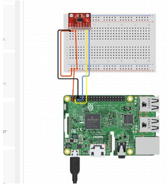

We’ve run through quite a lot of information. Let’s put some of it into practice using our Raspberry Pi and the circuit.io app.
Step 1: Go to circuito.io
Your first step should be to navigate to the circuito.io circuit design tool. Do so, while keeping this article open in another window.
Step 2: Add your components
We’re going to hook up our Raspberry Pi 3 with an adxl345 digital accelerometer. Type ‘Raspberry Pi’ into the search bar and the RPi should be among the topmost results. There are two ways to add the component: you can either drag it into the empty space, or you can click on it for a preview, and then click the red ‘add’ button. It will replace the Arduino that’s in there by default. Now do the same with the adxl345.
Raspberry Pi example circuit
A breadboard will automatically appear, and the connections between the two devices will be made for you. You should wire the two devices up according to the generated instructions. In this case, they’re simple enough that you can simply glance at the diagram.
